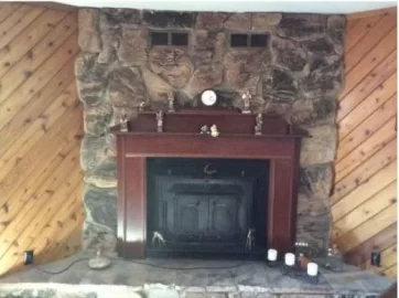

Put an offer on a nice 1967 ranch in a great location. Needs lots of updates, most of which I can do myself.
I know nothing about wood stoves and assumed (!) that any issue it might have would be a fairly inexpensive fix (less than 1k). Our house in NC has a wood burning fireplace, we put about 800$ worth of work into it and it's in great shape. So when we put an offer on the house and were told there were no issues with the fireplace, we didn't expect what we found.

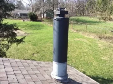

Our chimney sweep went in for a cleaning and inspection. Found everything is wrong and unsafe to operate. Copy-pasted from the report :
Sweep and Level 1 inspection
Found firebox of wood burning stove to be rusted.
Cracks in wood stove on both sides of damper.
Damper handle is not functional.
Clearance from stove to wood mantel should be minimum 20".
Exterior cap missing.
Top of chimney has incorrect cap size.
Fireplace not up to code to use at this time.
Wood stove and venting system must be replaced.
(And he goes on to quote us 12k for the complete removal of the stone veneer and current set-up plus a new stove, new veneer, new mantle and new chimney. OUCH.)
Now they hire a guy who supposedly specializes in these stoves and he tells us he can take it out, reweld it, fix the damper and put a cap on it for 750$. Of course that's all the sellers are willing to do.
How does that work as far as code goes? Is that an option? What are the chances of my kids and my husband burning to a crisp with this thing burning wood in the house? Would my insurance deny a claim?
Any input is appreciated.
