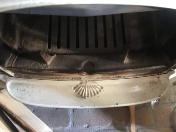

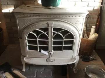

Hi all. First time poster here. Looking for a little help with my Jotul Firelight 12. It’s an older model I believe, with no access to the air control lever. Some models I see have a small plate with 2 screws to access the control, not mine. When I move the lever to adjust air flow I feel no resistance at all. I believe the lever has disconnected from the linkage? I’m having quite a bit of trouble burning the stove this year and I believe this is the culprit. Has anyone here had to work on this? I’ve searched the forum and can’t find any answers to this particular issue. Any help would be greatly appreciated. Have a great day.

The early Firelight 12’s lacked an access panel to get at this mechanism, and they apparently realized this was a problem, as they added it sometime before 1996. I had three Jotul Firelights, and the earliest among them (1993 model) lacked an access panel. I purchased one, cut the required window and drilled/tapped the required holes, to install it in the older stove. All you need is an angle grinder, masking tape, screws, tap, gasket (3/16”) and some brass cahones. Pretty basic modification, and you’re going to need to do it to get at that mechanism, without complete stove disassembly and re-cementing the entire thing.

Thank you for this reply. I was afraid that I would have to take it completely apart to get at it. I will try for the modification instead. Where did you purchase the access plate?
