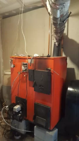

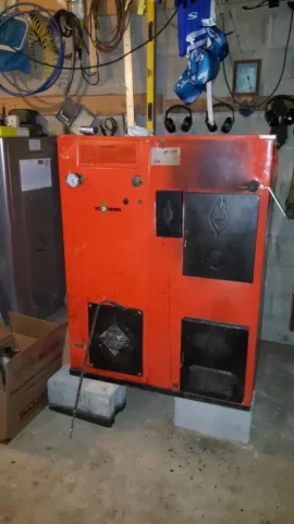

I came across a CL ad looking to get rid of an older HS Tarm ot 35(1100lbs) , the boiler is still operating, now with a converted beckett waste oil burner (seller has original beckett), the seller bought it 4 yrs ago from a guy who refurbs/test them in NH I think and burned wood the first 3 yrs before the switch to waste oil.
The boiler was at 200°f and 20 psi and in pretty good shape for a late 70s early 80s keeping his 3000sqft house warm .
The visible gaskets(supply/return/domestic tank-(not in use)) and flanges all look good with no rust.

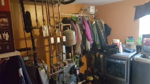

My current Oil boiler is in the laundry room now, not my first choice, but without a basement I am limited in options. My wife will most likely be against the combo being in there also, that's where a small outbuilding would work the best.
I am not enthusiastic about having to go outside to load it and she more then likely will never load it, plus the wasted btus not in the house.View attachment 178602
There is no way I would put a wood burner in a room like that. Smoke & ash spillage will end up in your clean clothes, for starters.

I talked to the town inspector and was told the garage install would be okay as long as I was 18" off the floor, so I went and picked the beast up tonight and got her set in my garage, still have a lot of work as far as cleaning her up, making a few upgrades and piping her in but am excited to have her home, the Mrs turned out to be okay with the adventure being the boiler is free thanks to scrap copper... sounds like a win in every direction, I will post updates as they take place.
