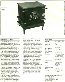

I have a spec sheet of some type on the OM80 Wood/Coal stove - I will upload to the wiki and post the URL here.
Here is basic spec - it was UL approved.
I have also started an old mill topic in the Wiki and have this and also another old mill spec sheet there.
As far as the 8" flue size, the reason for that is the large door opening. The stove will almost surely smoke out the doors if you downsize it. 8" flues are usually found on stoves with large open fronts for that specific reasons.
  • [Hearth.com] Old Mill Coal(/Wood) Stove

Well we don't KNOW that the stove he has is in fact an "Old Mill 80" as it could be a different model, but I noticed that the spec sheet says 6" flue.... Presumably if the existing flue draws OK then he should be able to use it.
Gooserider
Webmaster said:
Strange, I don't remember old mill making any coal stove other than the 80. Maybe he will post pics.
I agree, pix would be very helpful. I certainly don't claim any specific expertise on the stoves, I was just reading what is implied in some of the content...
In the brochure you posted, they talk about "Old Mill's other stoves" which implies that there are more than one, but no idea if they were coal, wood, or ???
In the original post, DonnieMac talks about it saying "There are no numbers or plates on it, but it does have “Old Mill” on the main door." - Note the singular DOOR, not doorS, however the photo in the spec sheet looks like it has a double door on the front. This would imply that either DonnieMac is careless in his language, or that he has a different stove. I can't tell which from here, so I have to be conditional about pointing out where the spec sheet says 6" flue pipe for that stove, sinc I don't know for sure what he has.
Pix would be nice, or he could just look at the spec sheet photo and dimensions and see if they match. Being paranoid, I'd check the dimensions to make sure I didn't have a similar model that was larger or smaller w/ the same look but different specs...
