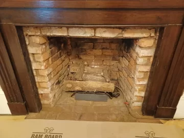

We'll need the dimensions of the fireplace to know what will fit or not. Pictures also help. How large is the fireplace room? Is it open to the rest of the floor or closed off by doors or hallways?
Fireplace room is 15 x 18 , closed off by doorways, but return air location near fireplace to hopefully help distribute heat through house
Will get a fireplace picture and dimensions

Dimensions on firebox : 34” wide and 32 1/2” high @ face
21” deep
25” width @ back
Mantel opening : 43” wide x 36” height
Insert or freestanding suggestions ?
Old Georgia Timber Frame - insert or freestanding stove suggestions ?
Either way wood trim probably won’t make clearances. 32” takes a lot of stoves out of play. I vote insert.
Yes, the mantel presents an issue. Freestanding won't work due to the deep box trim surrounding the opening unless the stove was recessed 100% in the fireplace. That trim looks to be about 3" deep. If anything will work, it will probably need to be a flush insert due to the mantel trim. The Lopi Medium Flush insert might work.
Not there to measure mantel depth but I’d say 3” is a fair guess. Will take at look at the Lopi - thanks for the suggestion
