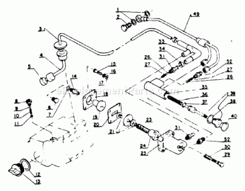

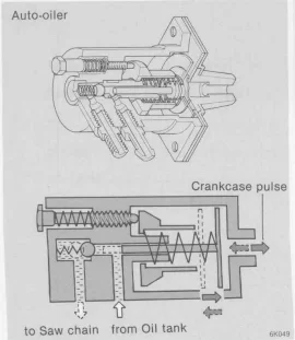

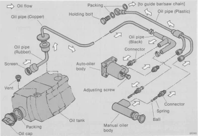

Hey all,
I've got a mechanic friend (not good with computers) who's trying to help out his neighbor with an Echo CS60S. With the saw assembled and running, the oiler (auto or hand) doesn't function. If he closes the oil line off going to the inlet on the automatic oiler, the hand oiler works perfectly. What we can't figure out, is that with no check valves on either the inlet (where we think it needs to be) or outlet of the auto oiler, how was the system supposed to function in the first place? We've checked the oil system parts against the breakdown and as far as he can tell, it's all there. As it seems now, both pumps are just "idling" in the circuit, pumping oil in circles between the inlet and outlet but not delivering to the bar. He's covered the basics and replaced all the lines that were questionable including the pickup in the tank. What are we missing here?
Thanks much for everyone's time and talent.
MM
