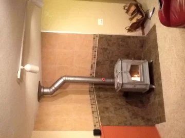

We'll guys it's finally done. Had my first fire tonight anyway.
I got the rear heat shield and outside air connector. I also painted the pipe to match the metallic brown on the stove, it blends in nicely with the wall.

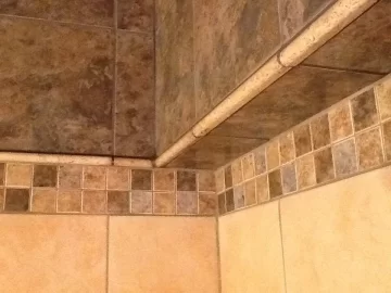

The rear shield allows 12 inches to the wall from the corners. The left side wall tile seemed to get pretty warm when the stove was at 350 or so. I plan to make a free standing shield for that side. I'm thinking 6 by 24 sheet metal with breaks on the edges to stiffen and attach the bottom to a solid piece of 1 by 1 solid iron bar I happen to have.
Probably not a big deal at 350 but when I get to 500 it might be a problem.

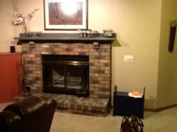

BEFORE
[Hearth.com] Okay here goes, lemme have it!

If your install meets the 12" CTC requirement, I wouldn't rush to put up a heat shield. . .maybe keep an eye on the tile temps with an IR thermometer. 500° stove top doesn't necessarily mean that the Fireview is throwing a lot of heat off the sides of the stove. It will, if you run it hard with lots of air and lots of flame in the firebox, but if you turn down the air for a mellow cat burn, much more heat comes off the top than off the sides of the stove. If you do the heat shield, I think it's supposed to be more effective with the bottom open to facilitate air movement behind the shield.
Good choice Dan, you should be happy with that stove and should be easy to learn to operate.
It is the infra red that is heating the dark tile.
I put a 4 inch wide 23 high piece of polished aluminum at the corner to reflect the IR and UV forward and the tile stayed barely warm. I'll make a permanent one that won't show much.
I'm running the cat as the book suggests after a nice bed of coals and 10 minutes after reloading.
The air intake is at 1.
The stove top then runs 375 and the pipe is around 225. Just a bit of fire on the wood but fire blobs forming out of the air near the top of the firebox dancing around.
