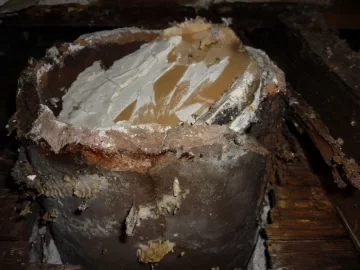

Ok folks, how do we seal this?
eclecticcottage
Dec 7, 2011
1,803
WNY
And, what was this for??
We're thinking a wall furnace maybe??
Background:
This is at our Old House. See the blog for more pics, we're doing demo and found this in the wall, going into a cinder block chimney on the other side. Scary thing is, when we bought the house and for the first two or so years, we used a gravity heater in the floor that was connected to the same chimney!! This place must have an angel of it's very own, I swear. The electric line that used to run along the side of the house was singed when we had it replaced. Before we bought it, some kids tried to burn it down but it wouldn't catch. Now we found a wire that was totally stripped today (we rewired the whole place, this was in the old K&T).
Anyway, here's the hole. We do not use the chimney now and don't plan to, but it's still there. Looking forward, we may sell the house one day and someone might decide to hang a furnace and use it again. I don't want the possibility of this venting into the wall in that case.
  • Ok folks, how do we seal this?
So the flue doesn't go through to the roof? I'd probably brick up the opening, plaster over it, and call it a day. Maybe foam the top so it doesn't draft. If somebody decides to use a chimney that doesn't vent to the outside... you can't fix stupid. I don't think you could be held responsible if they had to do so much work to access it. What's to stop them from sticking paper clips in the wall receptacles?

I guess I didn't explain this too well. It's a full exterior cinder block chimney, fully vented. It is a regular chimney. The gravity heater was in the floor next to where this was in the wall (we called it the hole in the floor, it basically looks like a radiator with a grate over it). This goes through the wall into the chimney which is on the outside. Like an old wood stove, only I don't think it was for a wood stove.

The thimble shown has plaster lath very close to it. It would definitely not qualify for a woodstove as shown.

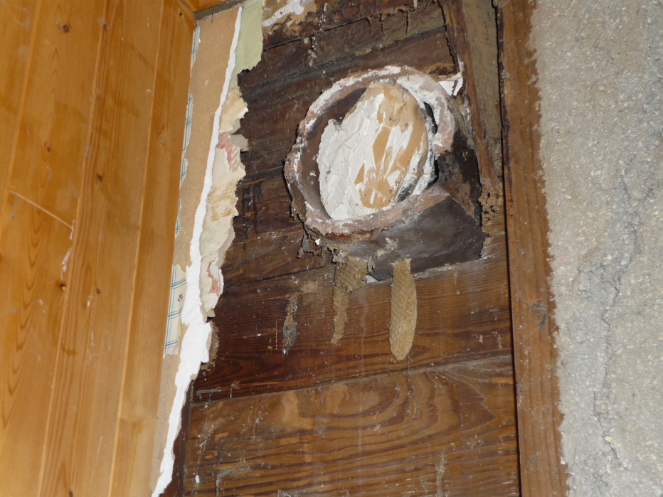

This is a better view with the wall in plain view
Note the bees nests. When we redid the ceiling a few years ago, we couldn't figure out how the bees got it to make nests. And now we know.
The wall with the paneling on the left was not originally there. We built that to match one on the other side, this is between the living and dining rooms.

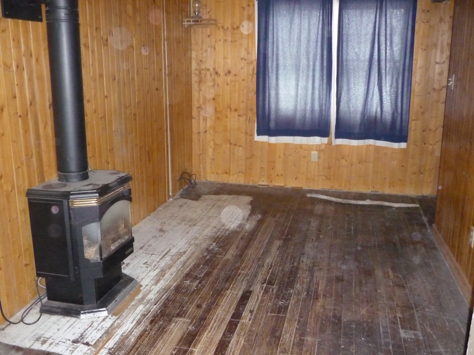

It's just outside of this photo on the left:

They put a plug in the hole and went right over the top of it. There are and were caps made to plug unused chimney access holes and some folks came up with their own variations.
I had a front row seat to one plug getting blown out into a living room due to a delayed ignition of an oil fired domestic hot water "boiler", it blew the plug through the wallpaper in a living room.
We're thinking of using a cement type product. We're also capping the chimney since it isn't being used but it would be a PITA to take down.
I filled a couple of those with some brick and mortar, it became chimney again.
Quickrete brand Hydroment cement, it expands when curing seals everything solid. As the name implies it is used to seal cracks / holes against water penetration.
Without a sealer no cement product is good for water prevention. "Hydro" i assume is in reference to it being a hydraulic cement, ie it expands as it cures. You have to be careful with something like that because it could expand so much it basically breaks its container. It would probably split a stove pipe in that large of a mass of concrete.
