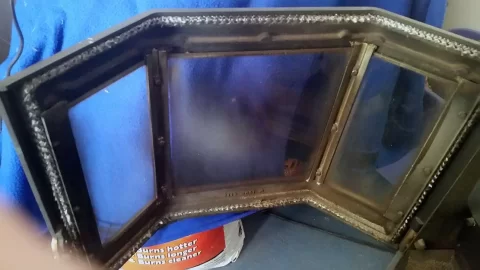

1992 Austroflamm Integra manual start......starts up great on high or medium setting runs for about 5 mins then the auger stops feeding pellets but you can hear it humming/ trying to turn? and the red light is on only for a brief second. Walk over turn it off then on again and wa la the red indicator light then stays on longer and pellets feed fire burns great for a few more minutes then stops feeding pellets again red light on for only a brief second, turn off turn on all is well again for a few mins ...rinse repeat for about an hour then finally it will take off and go normally til next time you need to start it up.
I am new to pellets stoves but have researched and understand how they work and the need for a clean clean stove and maintenance. I bought this used in Summer so too hot to run it til now.. LOL maybe thats why they sold it in hot weather
The stove was very clean and I additionally tore it down and cleaned everything fans motors air passage ways, exhaust and all new dura vent pipe out the wall short run , gaskets all good etc. I thought I was ahead of the game and ready for winter. They said Bear Mountain runs good in it so I bought a ton of BM. As soon as I needed heat I ran into this problem. To make sure it was not the pellets i burned out the hoppper of BM's and bought another brand "Pacific" same symptoms. Takes about an hour of turning off and on before it will run normally. Then no problem at all wonderful heat stove runs perfect til next time. What the heck is causing this? Anyone have any ideas? or ran into this before?
