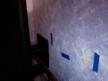

Here is a pic of my situation. the vertical blue tape shows the location of the wall studs and the horizontal tape show the location of the outside downspout. I was thinking either putting the oak on top of the exhaust or maybe try to squeeze it between the stud next to the vent and the downspout. It will be a tight squeeze but I think if I put it tight to the stud it will fit. I need to wait until it comes to see actual dimensions before I decide.You can also see that it won't be much lower than the exhaust because the exhaust is only about 8" from the floor and then the floor trim is there yet. [Hearth.com] OAK Question

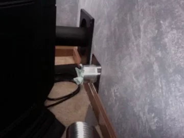

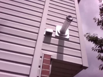

Well, I installed the OAK today, all went well. I was able to squeeze it in between the vent and the wall stud and exterior downspout. It is a little lower than the vent but more than 12" away from the end of it so all should be ok[Hearth.com] OAK Question[Hearth.com] OAK Question
