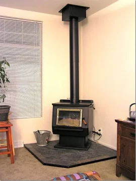

I have just had my new Blaze King Princess Ultra installed, and have yet to fire it up.
The guy who installed the stove did not install the OAK b/c he claimed that it's not necessary b/c my house is big, nearly 2000 sq. ft. The owner's manual says that an OAK is mandatory for all mobile homes.
My house is a new triple-wide manufactured home on a permanent foundation. So does "manufactured" equal "mobile"?
If I can operate efficiently and safely without an OAK, I'd prefer it b/c I'm not wild about drilling through my beautiful brick tiles to get to the crawlspace. Not to mention I'd have to undo the chimney and move the 450# stove again to install it.
Please weigh in - Winter's icy fingers are tapping on my walls...
