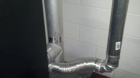

Well, after almost 2 seasons, I finally got around to installing the OAK on the Fahrenheit. I have had (most) parts since last year (but had to run and get a couple things today).
The install of a Fahrenheit by a certain (Unnamed Member ;)) person, finally got my butt in gear.
Took me all of 2 hrs and the Basement has NEVER hit 80° (on the far end/its about 95° near the wood eater).
My Quad has had an OAK and I have been a firm believer in them. But I have been a little lazy with the basement stoves. After the performance gains in just one evening. I will be doing my Wood eater next weekend.
(The silicone is Supposed to Dry Clear.... ?? I hope)
Anyways. For those that dont believe, my basement thermo never got above 78° in 2 yrs and tonight is colder than almost any night last season)
OAK's work :) And Thanks to the certain Unnamed Member!!! Your perfect looking install inspired me (hint : AMC, is in his User name) ;)

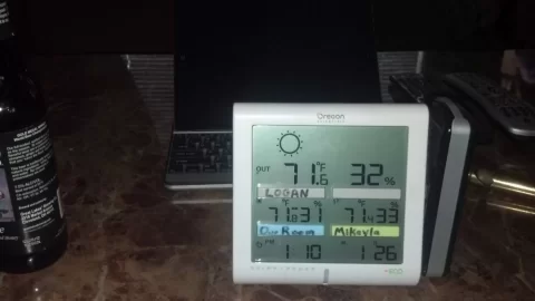

Last pic is the temp throughout the house :cool: Furnaces are the Chit.

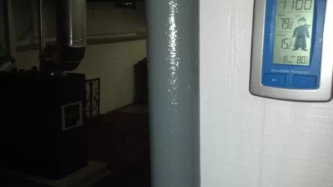

Here is the thermo in the basement. The stove is coals now and I am about to reload. It dropped below 80° while I was posting (its 79.8°, its pretty darn close!)

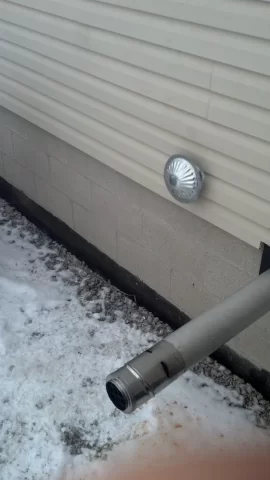

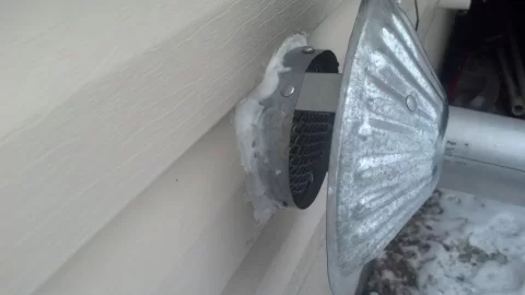

NIce dex, Where you get that inlet(cap) at? I would like to try something like that. High winds effect mine.
Its a 4" B vent/Gas cap (4") I then used a 4" to 3" reducer and used 3" all the way to the furnace.
Looking at it, I am going to use some flashing and cover the top, to prevent rain and snow from being drawn in.
Won't take but a minute.... Love it
Looks good. The clear silicone I used went on white also. Took a couple days to dry clear on mine. I blamed it on the cold.

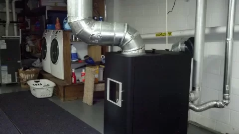

Nice washer and dryer Mad Dog...I will be looking for some help when I install my OAK!! Hope you will be available, I will have beer (not that fancy stuff in your picture, but it will be beer);) !! Lovin' your basement my friend!
Reactions: DexterDay

I gooped up some outside fittings I worked on a few weeks ago here with clear and the silicon took about a week to cure and turn clear. I would not worry about it.

Nice install, Dex. And your basement is so clean.
I like the raised basement wall off the ground floor. It protects the siding from rain splash, snow accumulation and insects. But I am sure those exposed blocks bleed a lot of heat from your basement.
Still worth it. At my place the siding goes to 6 inches from the ground and gives me all sorts of issues.
But you sure have a lot of heating capacity in that clean basement.

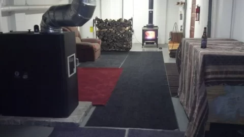

The basement isn't as clean as it looks... (Pics are definitely staged).
Like this one ;) (this pic is pre OAK) Now I gotta fill the wood racks and take another pic :)

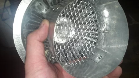

Dexterday Is that cap removable? Its hard to see in the picture but it looks like the screws wont remove the cap
Nope. Cap is not removable. But will be easy to clean. The screws hold the makeshift screen I put in it.
Nice job on the install Looks good. Thanks for the reply I was wondering about cleaning
