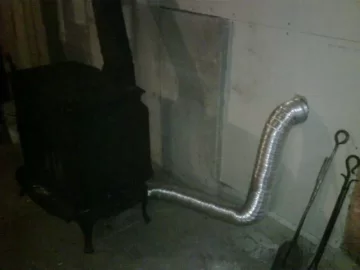

Well, spent today installing the OAK for the F600 (picture attached).
Made do with the following supplies:
One dryer vent
One length of metal dryer tubing
One OAK for the F600
A couple of questios:
1- Will I need to insulate the flexible pipe and if so, does anyone have recommendations?
2- DOes anyone have a sugestion on a "flapper" assembly so I can close the vent when not working the stove?
3- When I go to light the stove, do I have to be concerned about the glass- i.e. heating too fast? What about the cast?
Just some questions that came to mind as I installed the OAK.
Thanks.
One dryer vent
Thanks.
