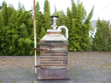

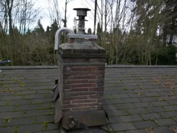

I want to have an OAK installed, but my dealer tells me that is not possible in my case because my chimney has no connection to the outside (its in the middle of the house and sourounded by dining rm, bedroom, hallway and living room) and they usually go straight out and do NOT go all the way up the chimney to draw air from there.
Is that reasonable ? I somehow thought I have seen chimney caps with two liners running down, one for exhaust and one smaller ID for air intake - but I might very well be wrong. Is an OAK always straight out ? Does is depend on the stove and what the fan can draw ? Is there a certain chimney height limit ?
Any thoughts very welcome, thx
