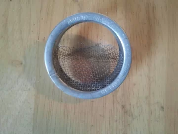

Last winter I had and ice problem on the OAK louver screen and I broke the screen getting the ice off. Starting to think about heating season and replacing it and had a quick question. On the outside of the louver it says Maurice Franklin Louver Co so I searched the name and found this;
[Hearth.com] OAK exterior screen question
I'm thinking that this style (it is screened) may help with ice but my question is will it impede air flow? My sense is no, but wanted some opinions.

Id say its too restrictive! And it would also ice over relatively easy, probably easier than the old one.

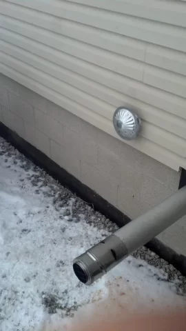

I have a elbow on mine so it faces the ground, eliminating all ice, snow & rain issues. And I cut a regular piece of 1/8" screen to fit inside to keep flying things out.

I used 3" galvanized stove pipe for my OAK, and a regular 3" 90 elbow, hence the need to custom cut a screen to fit inside. But it wourks GREAT !

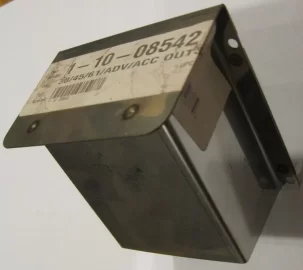

Get some sheet metal and make one of these...
(broken link removed to http://www.hechlers.com/store/index.php?main_page=product_info&products_id=584)

Mine is PVC. 2" street 90. No screen in it.
I thought code was non combustible material ? I went 3" with my length of run, and Harman's minimum is 2 3/8 with their flexible pipe size.

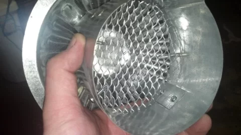

I used some metal "Gutter Guard". Bent it a lip and put some screws to hold it. Big enough to allow go flow, but small enough to keep out bigger animals. Bees and wasps can still get in, but I block the OAK and exhaust. So they need to find a home elsewhere. :)
[Hearth.com] OAK exterior screen question [Hearth.com] OAK exterior screen question

That screen in the first picture, allows less air flow than the bottom one. My bet based on personal use of such a screen is that it will likely cause burn issues, but you can try it and see for yourself.
