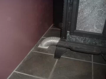

I am trying to get ready for the new EQ coming. My dealer has not seen one yet. Is the air go into the stove back bottom center? Is a 3inch line OK? does the kit come with flex 3 inch. Your help is very much appreciated! It takes my dealer a long time to find out and get back to me

Only thing better is to download the manual from Hearthstone but when I read it they did not specify left or right rear on the outlet. You can view it online at their site.
Mine was on the bottom, rear, and left side when looking at the front glass. Heritage. OAK kit was simply the nipple and you buy the flex at home depot. Take a click at the OAK in my sig.
  • [Hearth.com] OAK Equinox
Thanks, a picture is worth 1000 words
