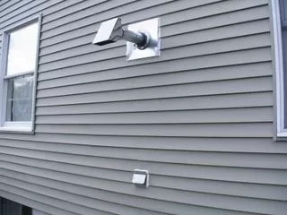

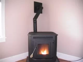

Hi,
Please see my pic attached. I keep my stove at ---3 bottom buttons 5-5-1, top 2 buttons (right now because it's not that cold) 1-2, all from left to right.
  • [Hearth.com] Now what is it?

Haha, got me macman left to right. I'll fix it. Thanks
