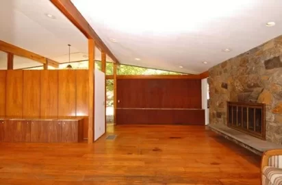

We have a large raised firebox fireplace, (fieldstone) with a long raised floating hearth extension--a continuous slab of stone about 16" wide--pinned and mortared in place. The wood flooring runs up to the fieldstone face.
If we flush mount an insert, will the existing floating hearth meet the requirement?
If we use an insert that extends onto the floating hearth, do we need to add a deeper non-combustible pad underneath where the insert sits?
What size is your fireplace opening? I would think that if your hearth is the required size and has been built on non-combustible material it would be fine, It would help if you included a picture of your fireplace to better understand your situation. You will also have to find out what stove you will consider and check to make sure that all clearances are met including the hearth and mantel.
Picture is worth a 1000 words--sorry it's not better, but the FP is covered in construction materials at present.
-Fire place is 63” wide x 30” high by ~24” deep.
-masonry firebox, rough fieldstone facing floor to ceiling with a wide (& long) raised hearth--about 16” deep
-internal single floor chimney (<25 feet as a guess)--sits between the great room area and master bedroom wing.
-the chimney has a single round flue that is about 24” across & the damper ledge may allow the 6” pipe to clear without a problem
I've been going back and forth on insert vs stove--last spring a couple of folks were encouraging me to go with the stove set into the opening.
But back to the original question, if I extend out onto the hearth extension (say with a regency hearth heater), will I need non-combustible material below it?

Not an expert here, but I think the answer is yes. However, air is a good insulator, and that should be taken into account for the floor hearth extension R value.
