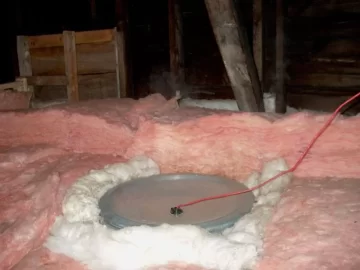

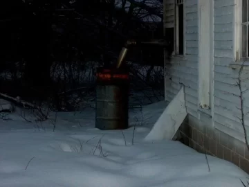

Ran out of wood yesterday.(burning oil grrr) Now I have 1875 gal of water and exposed plumbing in an unheated building in February? Yup, but I have planned for this. Now the test. It's crude, temporary and manual, at this point, but I think it's working. Will dress it up after I'm sure it works. It was 19 degrees last night. So far, so good.

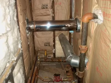

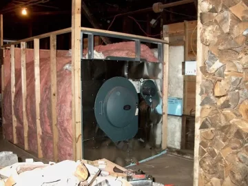

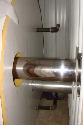

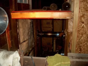

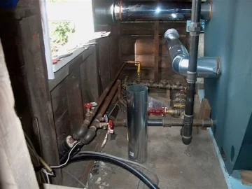

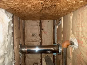

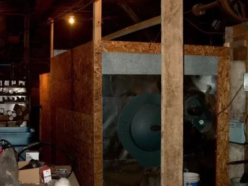

So I put the Garn in a corner of an existing building. Kept the boiler and all the plumbing within an insulated enclosure.
