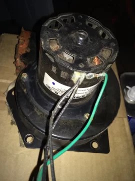

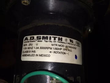

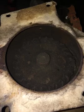

New Pelpro Accutron 4 control panel, new vacuum switch. Stove and venting is clean!
A.O. Smith Exhaust Motot runs fine but look at it!
  • no vacuum to hold in air switch - stove is clean - look at this!

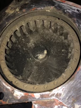

Motor not clean.YUCK!!!!!!!!!!! At one time did that have fins on that fan blade setup?
Yes
