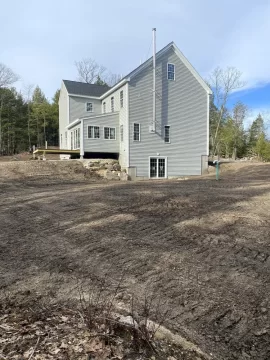

My wife and I are new owners of a Hearthstone Manchester that was installed in May (new construction home in New Hampshire). I had a few questions about stove operation.
First off, the stove is installed in our first floor living room with a vertical (black) double walled pipe that goes up a few feet and then does a 90 degree turn which leads out to a stainless run of at least 30 feet. It was installed by a quality and reputable dealer of yours. Also this is not our first wood stove and we are experienced with Hearthstone stoves. However, this is our first stove with a cat.

I can't answer the cat question, but soapstone usually sits around 400 degrees +/- 50. Any hotter than that and you risk cracking the soapstone. I think with the cat engaged, they stones will be slightly cooler anyway so I'd be surprised if you can even hit 600. Beautiful stove. I would have to think you have some pretty good draft with a 30' chimney.

Thanks for the reply. The Manchester is a cast iron stove with a few soapstone bricks lining the interior. So it's not a true 100% soap stove stove where those ~450F stop top temps really make sense. Most fires I've had hit that ~600 to ~650F no problem with the cat thermometer pegged at the line between "active" and "too hot." I just worry about creosote, who knows maybe with the cat I don't have to worry too much.

If you're hitting temps like that, you have no creosote. Might want to add an inline damper to avoid over firing. I'm sure other more seasoned burners will chime in with good advice.
