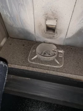

Thank you so so much Bill !! You’ve made me feel 100 times better about this stove! I’ve always had a wood stove but i would never leave the house with it burning an I was up all night checking on it in fear of fire so I feel so much safer with this stove however the learning process is gonna take some time so I really appreciate your responses! Thanks again !!Jean, your firebox looks great! First, Your owners manual spells out what to clean and when. Usually for most stoves, the weekly cleaning consists of nothing more than vacuuming out the stove as you have done. The monthly cleaning usually consists of removing some or all of the baffles, plates...hoodickys so that you can get all the extra ash and deposits out of all the now exposed crevices. That and cleaning the glass (another learning experience) and you will be a first year rookie in control! Don’t forget to read about the do’s and don’t’s about vacuuming your stove out! Hot ashes sucked up in some types of vac’s even fancy stove vacs can catch on fireIf you have to be stuck at home this winter more than usual, now is the time to learn more about your stove.

Well don’t I feel stupid lol yes when I clean the fire pot an pull the thingy then a little ash falls down.. not much but some an some clinkers. But dang the inside of the box all around the fire pot I have to vacuum daily. It gets about an inch of ash inside the stove on the floor around the fire pot.The only ash that will go into your ash pan is when you clean the firepot with the firepot cleaning rod daily.
Cleaning Firepot with Cleaning Rod & Firepot
Clean-Out Tool
• Frequency: Daily or more often as needed
• By: Homeowner
a. The appliance must be in complete shutdown and cool
and the exhaust blower off. If you are just cleaning
the firepot, there is no need to unplug the appliance.
b. Locate the firepot cleaning rod on the right side
of the appliance. (“Figure 7”). When you pull the
cleaning rod straight out it will slide open the firepot
floor to allow the ashes to be deposited in the ash
drawer. You will see the light colour painted area on
the cleaning rod to let you know the rod is in OPEN
position. (“Figure 8”)
c. Pull the firepot cleaning rod OUT and IN a couple of
times to help shake debris loose. If the rod is hard to
pull, it may be necessary to use your firepot cleanout
tool to chip away material that has built up on the
bottom plate of the firepot and to push out any clinkers
while in the open position.
d. To close the firepot floor: slightly raise the cleaning
rod and then push it back into place. If you have
closed the cleaning rod properly (pushed all the way
in) you will not see any of the light colour painted area.
(“Figure 8”).
e. Always have the ash drawer in place before pulling
the firepot cleaning rod, otherwise the ashes will fall
down and fill the outside air opening and the appliance
will produce soot out of the exhaust and will affect
