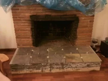

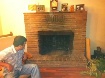

After many weeks of planning and preparing, working alone and with friends who had fortunately not realized what they were in for when they agreed to help, I finally got my insert installed! Having had fire on the brain for a while now, and having benefited greatly from the advice and photos found on this forum, here are a few pics.

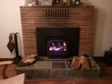

You can see the before--and before that it was actually covered with a built in bookcase, and full of insulation, rat nest and old dog food rats packed in. I had to pull out an old 8" pipe and cut out the damper and some bricks. The in progress shot shows how I extended the hearth which I would definitely do differently next time, but feels really solid and is working well. The final shot is the first fire.
I am curious about the opinion of, or advice from anyone else who knows or uses this stove, Lopi Republic 1250i. It was a snap to start a good fire in it last night with seasoned fir. When it got a big piece of seasoned oak it definitely slowed down but I may have added it too soon. The blower worked great. My chimney is about a foot short of the recommended 15' so I am half expecting to have some kind of draft problem but so far (1 night) so good.
