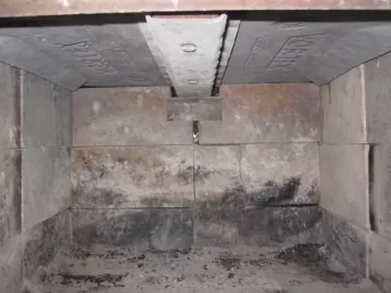

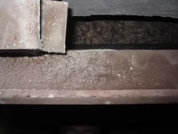

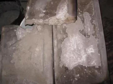

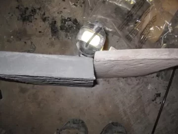

We had a bit of a mild spell today, so i shut down the stove to do some maintenance.,
I cleaned out the old ashes and changed my baffles.
I attached a few pictures of the install and a comparison between the old and new design baffles and the tighter clearance in the front. In order to install the new design baffles the top two rows of bricks need to be removed. Anyone considering the upgrade should consider the downtime to allow the stove to cool. The new baffles really do lock in there much tighter than the old ones
Im getting the stove up to temperature now. I have noticed an improvement in secondary burn however i haven't seen an increase in heat output. Ill keep an eye on it and update.

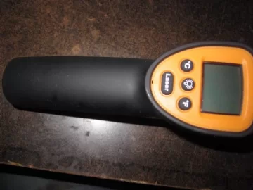

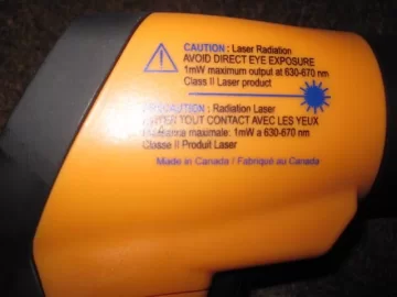

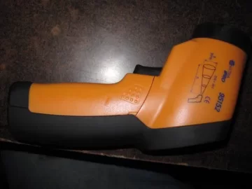

Went out today and got a IR thermometer. I couldnt find a Raytek, but i may have found something better!
Its a Ultrapro 95152, made by GTC. Imagine my surprise when i saw a "Made In Canada" on the label!!! Most of this stuff is out of china. So i bought it :D So far it seems like a good unit for $79.00 which is the same price as the Raytek
Now at least i have a means of accurate temperatures.
I think the baffles made a difference at least in stove operation, but not in room temperature.
Stovetop (near front edge) : 517 F
Stovepipe Surface :236 F which is exactly what my SBI magnetic thermo was reading.
These numbers seem to be about where i should be? Now i need to look at other reasons why im not getting my house temps up.
