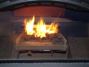

Ok, day 2 of my first pellet stove, a Harman P61A and I'm thinking something is wrong, a lot of buildup on the burnpot, adding a pic of what it looks like this morning, suggestions please as we have no clue what to do. It is on a feed rate of 3 and Low Room Temperature mode, set to about 65. I don't know if the airflow is wrong or if there is a seal leak or what else to check, my dealer is closed Mondays so no help there. Does anyone know a good way to check the seal? Does anyone even think that's what it could be? Anyone know of another post on here that may help? it's hard because we don't know what to search for, any help is greatly appreciated!!

Other than lot of buildup in the burnpot what is wrong? It does look ok to me with the one picture. Are you familiar with the way Harmans work? I tried to look for a video on the operation of the stove but I can not find one. I will keep looking.

when i had my p68 that is how it looked all the time, the bottom feed operation is as advertised.
make sure your burn chute is clean and the holes are free of creosote.

Unless you are there every 3-4 minutes you will get a buildup on a bottom feeding stove. Did you dealer explain this to you? Did he not show you how the stove works? When the stove was installed did the installer run the stove and show you everything to expect with the stove (good fire vs. bad fire)?

Why would you think it is not burning correctly? The ash in your pic
looks normal to me too. The ash will get pushed into the ash pan when
more pellets are fed through.

That burn pot is actually very clean. I let mine go 2-3 days before I scrape.
Your burnpot will fill with ashes that will be pushed out by incoming pellets and will fall into the ash pan.
It looks normal to me too. In fact, I wish my burn pot looked like that after burning a certain brand of pellet I am trying to use up.

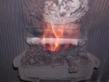

Here's mine after 3 days.

I also am pretty new to pellets having just burned my first ton in my P61. I've been afraid to leave my burn pot looking like the one pictured above (three day burn) so I've been scraping forward into the ash pot every 12 hours at least. Are you all saying it is OK to leave it looking like it will smother the fire? If this is the case it would make my situation infinitely easier. Also, I read that bulletin and tried it last night. It seemed to work pretty well, but I don't understand the point to flipping the toggle from auto to manual before scraping. Wouldn't turning the stove or room temp down be enough?
My p68 will leave a residue similar to yours when it is burning on low because it does not have the efficiency to completely burn the pellets on low but when on medium to high it burns cleaner and more completely. Don't worry everything is running normally.

The fire looks just fine to me and is exactly like my Harman burns at #3.
I scrape every 2-3 days and (maybe could go longer) I do not tun the stove off. The flame usually goes out before I`m finished scraping but it always re-ignites immediately after closing the door. This works really neat since I don`t have an auto start feature .
The one thing I do that is different and works better is that I turn up the fuel rate to maximum just before I open the door to scrape. This causes more draft to remove the smoke and dust from scraping and with the door open no pellets get fed into the burnpot. I also turn off the stove blower just in case any smoke or dust (from scraping the burnpot) escapes does not get blown about the room.
