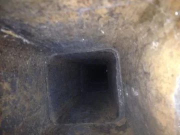

The current chimney was only used by the previous owner with a wood burner. The flue opening is clay lined 7.25in square. Is it even worth my time trying to get a wrapped 6" liner down it? Is 5.5" liner acceptable? Or should I scrap the idea and just run new pipe elsewhere?

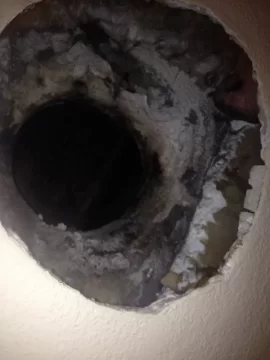

There are obvious codes about chimney heights and restrictions. The one thing I can't find is do inspectors consider an existing chimney as part of the distance (or part of the building) if I were to run new pipe a few feet away from an existing not used chimney? Or should I run the pipe within a few feet and then remove chimney brick to lower it's height since it's not in use? I want the stove to be in a similar spot as the previous chimney so I might need some diagonals to get some distance away from the current chimney.
Sorry, these questions are probably pretty basic and maybe not very clear.
I attached a pic of the wall opening.

I just want it built up so there is a visual barrier. Maybe it will help keep the kids away. Anyone have any opinions or experience with trying to get a 6 inch liner down a 7.25 inch flue?
Is it 7.25 internal diameter? A 6" flex liner has an outer diameter of ~6.25", and if you add about 1.5" for the insulation, you are looking at around 7.75" total outer diameter of the new liner.
A 5.5" might work. That would come out at around 6.75" OD. Still snug. How tall is the chimney?
The chimney is about 25'. Is renting a tile breaker tool a fairly simple task? I'm pretty handy and wouldn't mind the project. I assume that would open up plenty of room or a insulated liner. Also the chimney runs down the wall in the garage and is all cinder block. Is that common? Would a liner work with cinder block?
Chimney in garage is not uncommon. Haven't heard of a tile breaker being for rent and have never personally done it. Best to have a sweep answer that question.
