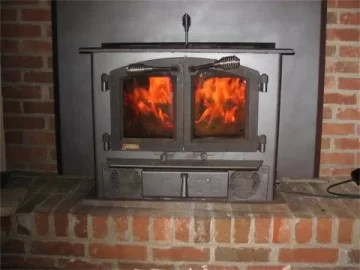

I will be able to tell ya later this week. I am replacing my insert with a free stander half in and half out of the fireplace. The belief being that it will heat better. Film at eleven.
The blower reason is a good one. Except that my old insert extended way out onto the hearth and when we lost power for a week last year we never noticed the difference without the blowers. I had always wondered but never tested it because I was concerned about the fans getting too hot when they weren't drawing air through them. But a blower is an option with a lot of free standing stoves. Well, if it isn't a Jotul it is.
We will try the stove on the hearth and see if we have been trapping any hot air back behind that surround panel. I bet we have.

BB - Which model insert are you replacing with which stove?
Mike:
"BB - Whihch model insert are you replacing with which stove?"
It is replacing my 1985 Sierra T-4600. Gonna be some big shoes for it to fill. Installing the Englander 30-NCL in my avitar.
