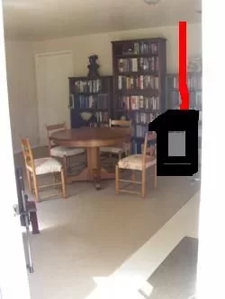

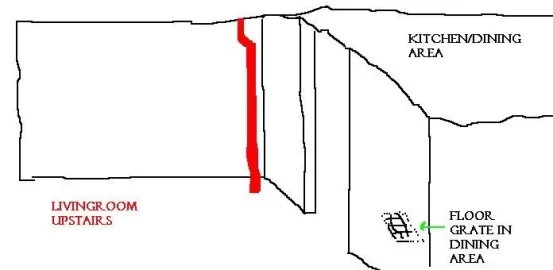

The home was built by a farmer in the late 50's/early 60's. It is a 2 level 1800 sq ft home including finished walkout basement, which serves as the main entrance. The main living area is upstairs, 2 bedrooms, full bathroom, kitchen, dining area. The basement has a 3rd room, 2ndary living room, laundry, and a 3/4 bath. There is a large stairwell (about 4.5 ft wide) from the laundry room to the kitchen. THere is a cut out between 2nd story living room floor support beams and the downstairs living area covered with a grate (presumably for the old stove set up removed by a prior owner due to back drafting of smoke).

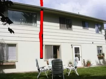

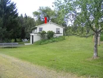

I am not certain as to where the pipe should run, however. I initially thought I would place it outside from the basement through the wall and up the side of the house, where an unlined masonary chimney used to be. I then considered running it in the house from the basement through she upstairs living space through the roof. My third consideration is placing it in the upstairs living area. My uncle suggested 2 stoves- the Enlander upstairs and the Fisher Baby Bear downstairs.
The 2nd level floor has 16" spaced beams as do the rafters. Unfortunately, they are offset by about 3 inches, so I can't just run the pipe straight up from the basement without putting angled pieces in. I will not be building a chase this winter if the install goes outside. I will not be placing a masonry chimney, either.
