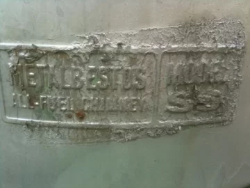

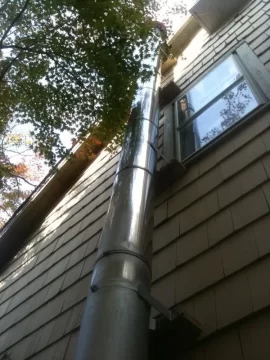

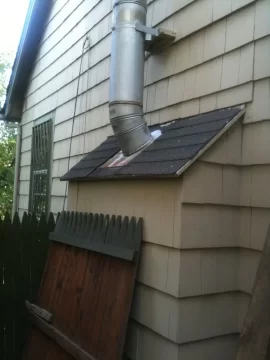

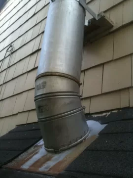

So Ive been lurking on and off for the last 3 months.. I have a steel fabricated outside chimney with a fabricated insulated fireplace. I had my chimney cleaned and inspected its all good. i recently found a Vermont casting resolute acclaim non-catalytic stove which would heat my 1200 square foot home.. i downloaded the manual for the stove and was looking at the chimney requirements.. my question is that I have metalbestos all-fuel model SS. Would this meet the requirements for a stove?? i measured the distance around my hearth and feel confident I am within there suggested distance for all sides.. Thanks for all your help
