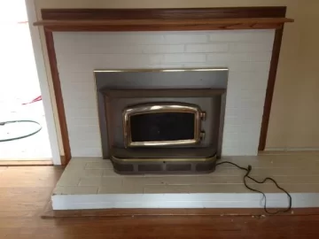

Can someone id this insert? What problems should I look for? Will I need a permit to install? I have oval style flue clay tiles. Best place to by SS liner? Did I miss anything? Thanks in Advance.
Jay
I would try to find a Lopi or an Avalon. Easiest to service and good parts availability. Also 6" outlet is cheaper for chimney liner.
I agree they're scarce. That's a clue...Thanks Ed, I was looking at getting a lopi freedom, but hard to find used.
