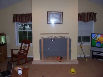

We're looking at installing a pellet stove insert as a replacement to our existing propane fireplace - the prospect of shelling out several thousand dollars this year for heating oil has forced us to do something! The existing fireplace is not masonry - just a wood frame with a 6 1/2" OD type B vent extending from the gas fireplace directly through the roof. There does not appear to be any clearance between the vent pipe and the insulation at the ceiling. (I've got some pictures, just nolt sure how to upload 'em)

![Newbie install question (pellet stove venting) Newbie install question (pellet stove venting)](/talk/proxy.php?image=http%3A%2F%2F1100_3567.jpg&hash=f3a41343ca4c88e1e0c62a232f675564)
