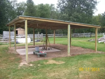

Finally done built new wood shed. The size is 20' x 24'. front is 8.5' back is 6.5'. It has outdoor type 4 lights, two outlets and switch. I will post picture as soon as I learn how to reduce from 1251 KB to 1100 KB unless someone can tell me how to do. Thanks!

Nice shed that baby is gonna hold a lot of wood
So Mn whats the detail's on the design, footings, roof, rafters, etc
Posts are treated 4x6 , drilled 3.5 feet deep and poured cement with 8 posts, middle post is free stand sit on old cement slab (with bolt drilled in slab and post) all rafters are treated 2x4 and 2x6's. Used galvanized lug screws (1/2 x 4) with galvanized washers on 2x6 connect on posts. Used zinc metal connectors to hold 2x4 and 2x6 rafters with deck screws type. NO nails. Steel roof are recycled from other three old buildings I torn down. Hope it will answer ur questions.
wood spliter said:
Great shed. Is that a slab in the middle? If so are you doing to pour the rest of the foot print?
Thanks! that old cement slab was old wooden shed with other 3 buildings attached it. you can see bare soil area. I used same measurement for new wood shed. I have several plastic pallets and will use it to hold firewood.
