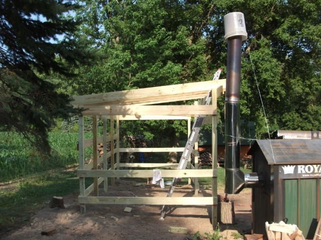

Finally got around to building my new wood shed. After our first winter with no actual wood storage, I figured it was time to build one. Little did I know that when I took vacation for this past week back in Feburary...that it was going to be 100F+ degrees outside everyday !!
Total size is 9'x18', with a 7' tall entrance sloping to 6' in the rear. If I stack nicely I should be able to fit about 6 cord inside. The one side is going to remain enclosed to store kilning and my family of Fiskars mauls !

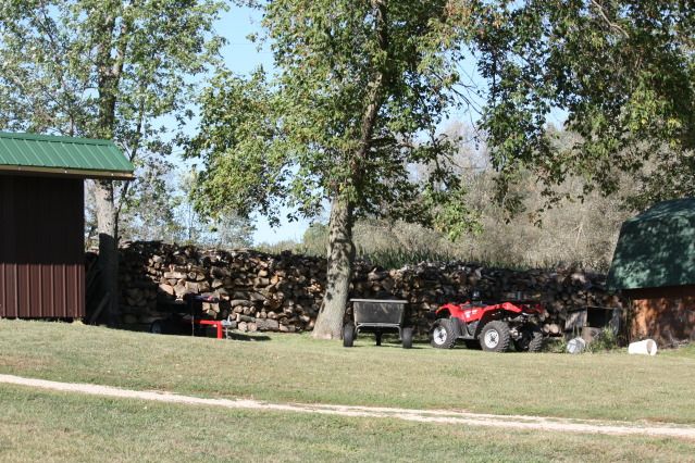

So we used to stack our wood here next to the stove on pallets and cover it with tarps...

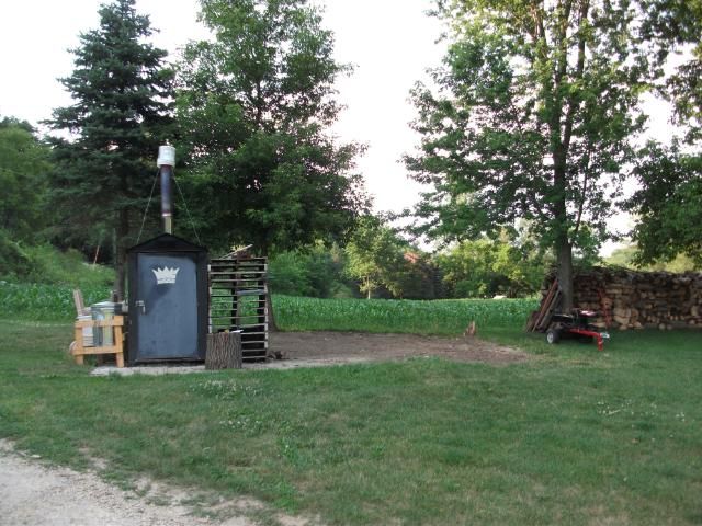

Needed to remove a small tree that was planted by the previous owner right next to the stove..

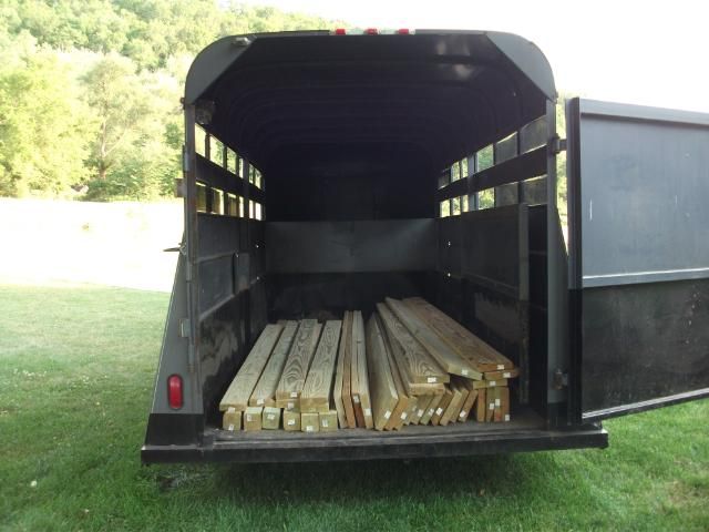

Picked up all the treated wood from Menards this past weekend..the main posts are 4x4s with other wood being a combo of 2x6s and 2x8s for the roof. Bought everything in 12' lengths and it all fit in the horse trailer perfectly.

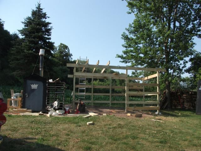

Over the past three days this is what I have done in a few stages..mostly because of the 110-115 degree heat index everyday..
Hoping to get the front overhang finished early this week and hopefully get the metal roof and sides on the following week![Smile :) :)](/talk/styles/default/xenforo/smileys/grin.gif)

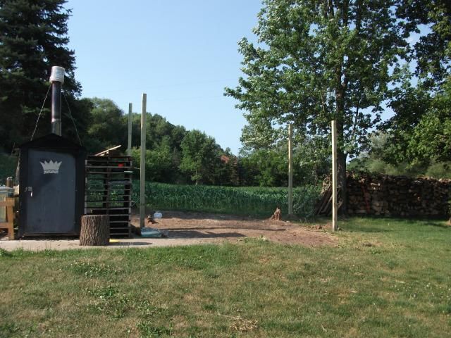

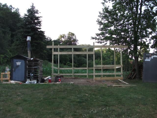

![New wood shed build New wood shed build](/talk/proxy.php?image=http%3A%2F%2Fi275.photobucket.com%2Falbums%2Fjj298%2Flibbymedic%2Fwood%2520shed%2520build%2FDSCF0922.jpg&hash=7989922ff10bbd6799ad5a4da42cb6c1)

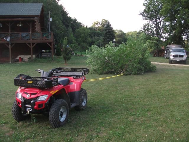

![New wood shed build New wood shed build](/talk/proxy.php?image=http%3A%2F%2Fi275.photobucket.com%2Falbums%2Fjj298%2Flibbymedic%2Fwood%2520shed%2520build%2FDSCF0924.jpg&hash=faf88377a83c75783fcf68cdbc1caaed)
![New wood shed build New wood shed build](/talk/proxy.php?image=http%3A%2F%2Fi275.photobucket.com%2Falbums%2Fjj298%2Flibbymedic%2Fwood%2520shed%2520build%2FDSCF0923.jpg&hash=8cc480e3f8b30c2bd3679e966255d373)

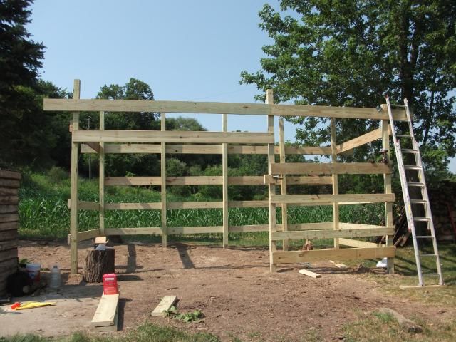

![New wood shed build New wood shed build](/talk/proxy.php?image=http%3A%2F%2Fi275.photobucket.com%2Falbums%2Fjj298%2Flibbymedic%2Fwood%2520shed%2520build%2FDSCF0938.jpg&hash=672aeeca23c793ef63ebe5a7213fc341)
![New wood shed build New wood shed build](/talk/proxy.php?image=http%3A%2F%2Fi275.photobucket.com%2Falbums%2Fjj298%2Flibbymedic%2Fwood%2520shed%2520build%2FDSCF0942.jpg&hash=13dc293e96adf71620ddbb65e9cf36d1)
![New wood shed build New wood shed build](/talk/proxy.php?image=http%3A%2F%2Fi275.photobucket.com%2Falbums%2Fjj298%2Flibbymedic%2Fwood%2520shed%2520build%2FDSCF0944.jpg&hash=1eeab18469fd8c5eaee85361773b0b9e)
![New wood shed build New wood shed build](/talk/proxy.php?image=http%3A%2F%2Fi275.photobucket.com%2Falbums%2Fjj298%2Flibbymedic%2Fwood%2520shed%2520build%2FDSCF0945.jpg&hash=e43ff703ad13c6bde5751bfbcefd333c)
![New wood shed build New wood shed build](/talk/proxy.php?image=http%3A%2F%2Fi275.photobucket.com%2Falbums%2Fjj298%2Flibbymedic%2Fwood%2520shed%2520build%2FDSCF0949.jpg&hash=07249e1a6b09287d0c75571a28b4be48)
![New wood shed build New wood shed build](/talk/proxy.php?image=http%3A%2F%2Fi275.photobucket.com%2Falbums%2Fjj298%2Flibbymedic%2Fwood%2520shed%2520build%2FDSCF0950.jpg&hash=1cb01e8e719d672d3c245d6e8e1c7277)
