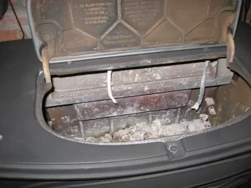

Some of you may have seen my post from Saturday about a gasket coming loose on a Vermont Castings stove that had been installed less than a month ago.
I just had two people here to repair the gasket. They found numerous gaskets that weren't cemented properly, as follows:
The damper frame was not cemented properly - parts had no cement on them.
The flue collar gasket had no cement on it all.
Neither the back panel gasket nor the side panel gasket were cemented properly - parts had no cement on them at all.
Repairing even the damper frame gasket required that they disassemble the stove, so this was not the type of repair that I could have done myself simply.
