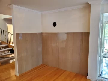

Here's some pics of the proposed area to install on the main floor. I'd like to take down the left wall so the area is even more open. The back wall is made of masonry blocks where the existing bore is located. Existing liner is 8x10" clay.

The HT2000 is fine. The Osburn 3500 is also worth looking at. In Jotul look at the F55. In PE look at the Summit and Alderlea T6. If eye-candy is important, the Quadrafire Explorer III is a great looking stove.
