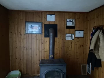

I have the manual, read it when I gave my insurance company the info they needed. I will have to find where I put it and double check on the exact stove. Here is a picture of the set up. I don’t know exactly how old the stove is. I am considering a new one next year, but a couple people have told mwle that all the new ones have parts that are expensive to maintain. This one keeps ny house too hot sometimes, especially the upstairs. But I will probably appreciate that in a month or so.
Yes, definitely locate the manual. It's important for understanding the stove operation. It looks like it might be a model 2478, but that needs confirming.
