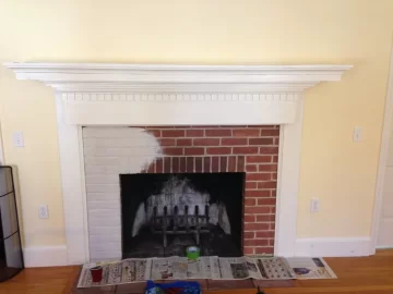

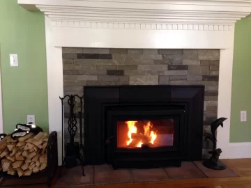

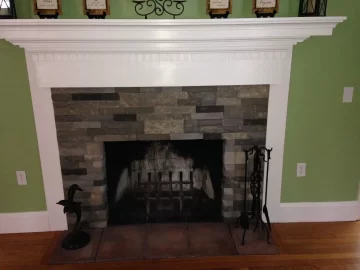

Hi All,
I'm new to the group and burning. I have a Hearthstone Clydesdale going in March 6th. I've attached pictures of my fireplace transformation so far, I will post the final once Clyde is in ==c.
I've been doing a lot of reading on here and research which led me to the Clyde as my choice! I'm sure I'll have plenty of questions as I go along but just wanted to say HI!

That's an impressive transformation. The Clyde will look great in there. Does the hearth have enough depth and at least a r-value of 1?

Grisu, If I remember the depth was 28" and yes on the R-1.. The local dealer came out to pre inspect and said I'd have no issues.
The only thing I'm struggling with is setting it back more flush or out... I like the looks flush and from what I read out doesn't really change heat out put too much?? The room it's going in is only 300sq ft, we do not use that room, I plan on heating the house the best I can from that room with fans. 2300 sq ft all together Ranch style 2 story 8 ft ceilings. Staircase is just out side that room to the left, dealer said the heat will go up there no problem..

Is that fireplace at an interior or exterior wall? At an interior wall, the heat trapped in the fireplace will warm up the surrounding wall and release it into the rooms over time, just slower. At an exterior wall, you may lose some heat to the outside unless you put insulation behind it. https://www.hearth.com/talk/threads/finally-got-around-to-insulating-my-fireplace.75755/ Are you getting a block-off plate?

Ha! It's s big fireplace! I can put in the largest inserts made... I think it's 37 wide by 29 tall and its deep...
It is an interior chimney .. Block off plate is going at the top of the chimney according to the dealer...
I was thinking of leaving it out slightly so I can get a therm. On the top sill.

Boy, that really looks nice. What did you cover the red brick with? Is it a tile or a stone veneer?

I highly recommend putting one in at the damper like this: https://www.hearth.com/talk/wiki/make-a-damper-sealing-block-off-plate/ That will give you much better heat retention. Otherwise, warm air will rise up the chimney, transfer its heat to any brick that is in contact with the outside (including unconditioned attic), fall back down as cool air and so on. Plus, even for an interior chimney an insulated liner is highly recommended especially if you are not certain that you have enough clearances.

He will probably be reluctant to install a proper block-off plate as it is essentially a custom job that they need to figure out during the install. Most dealers claim that it will be sufficient to stuff some Roxul (or worse since not approved for high temps: fiberglass) into the damper area. Nevertheless, most members here that switched from that to a real block-off plate noticed quite an improvement in the heat output of their insert. Given that it is an one-time job lasting easily as long as liner and insert are in place, I would insist on one.

Perfect... I'll do that. If push comes to shove I'll just have someone come out and install a proper one if it comes to that. Sounds worth the extra $$ if I have to
