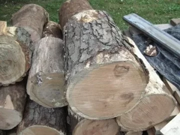

I'll try to post some pics....also try the start from far end and work towards myself. I did not expect it to split on the first swing but also didn't expect it to be so uncooperative!
Here is what I'm trying to split. Maybe red oak?

Those photos look like Black Cherry to me, and a pretty dry, dead one. Cherry should split fairly easily even when dry, unless you get a knot or crotch. Every tree will have a few sections that are hard to split, but I would expect relatively easy splitting from a cherry. Cherry also seasons relatively quickly, so it isn't a problem to leave a few of the tougher pieces a little larger for long burns. Keep at it. Once you get the hang of it, splitting wood with a splitting axe or a maul is not difficult, it is great excercise, and it is theraputic. Don't give in to the sit-on-your-butt-and-split crowd!
Yep, Black Cherry.....I'd use a wood grenade or spike and blast it apart.

Guess I have a lot to learn on wood ID!! I did check the MC on the freshly cut rounds and it was around 30%...if they are split soon would they be close to 20% by Feb.? I'm guessing that's too soon to reach that level?
If split now, you should be at 25% or less by Feb. Split it a little smaller if you're concerned.
