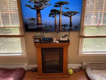

Hi Everyone,
First post here. My name is Andrew and I am from NJ. I bought a house a few years ago with oil heat and have wanted to put in a pellet stove since I moved in and this year I am finally going to pull the trigger. I have done quite a bit of research and am pretty set on picking up a comfortbilt HP22 stove. I will be installing it in my family room between two windows, and will need to put in an outside air kit in order to get the clearances for venting of 18" because of the clearances that I have. I am pretty mechanically inclined, but have some questions about the install and am in between cutting through my house for the exhaust myself or having someone come out to do it professionally. I plan on going straight out through my wall with a wall thimble, then do a T clean out, go up 3 feet or so, and then 90 out away from the house.
My main question is, has anyone else put a stove between windows and had issues? I am going to call my local fire department and make sure I am to code, but from the pipe and manufacturers instructions, it looks like with an OAK that you can be 18" away from the side of a window versus 48". I have about 60" total between the two windows, so I am fine with the 18", but it'll be a little close.
I have attached a picture here to show where I want to put the stove and where it makes the most sense in my house layout.
Thanks!
