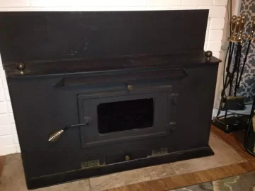

Like the title says I'm new this is my first full season of wood burning... Had a fire last night. I got it put out by turning all air off to stove and misting water down chimney. I know I need to clean my chimney good. It is a new ss 6" liner I put in last spring. Scared the living crap and of the wife and me but no damage. I've been burning wood alit this winter and was planning on cleaning the chimney soon.... The wood stove I have is older but was brand new web I bought it.... I'm thinking it's just to big for my house. I have 1100 square feet to heat and I have to leave the heater just barely smoldering or it runs us out..... I'll take all the advice I can get. I was burning well seasoned( well I thought) white oak.... Split it last spring but tree had been dead and down for 2 years!

It's a biltmore.... Made locally in sc it doesn't have air adjustment knobs only a ash drawer in the bottom that I use to adjust heat. Like I said I'm new at this and was planning on getting a good heater in a year or two. The insert is built very good has a thermostat controlled double squirrel cage fan. Chimney if in a sugar story house it's about 20' from top of stove to cap. I def think the most of my problems was from the fire smoldering but... As stated before I'm not sure what to do if j burned it any hotter you can't stay in the house it gets so hot....
I've heard of that but have never seen one. If it's seriously oversized, plus an old smoke dragon, then it's a bad combo, particularly if burning unseasoned wood. The chimney liner should be inspected to be sure it is still safe.

Ok yeah I'm thinking the stove is just to big and not the easiest to control with only the one air vent in it. The fire box it about 20" by 22" New to burning wood.... First chimney Fire!! the glass would stay clean when it was turned up going good but blacken up way to often. I'm gonna just let my wood sit another year and get a better stove by next fall!! And do some more learning from now to then.
