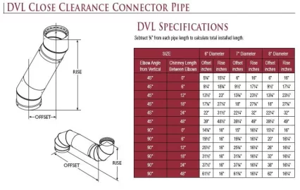

The other location is more desirable. So, unless it would have a significant negative effect, I will probably elect to go with the elbows. What's optimal placement of the elbows? I have a 9' ceiling.
What is the offset from the stove flue outlet to the class A support box?
I would come up off the stove with a short length of pipe, then the damper, then 45 + straight connector + 45 to the support box. Here is the offset chart for DuraVent DVL pipe.
