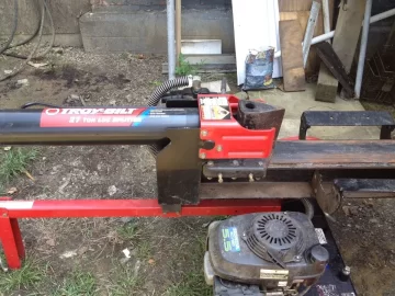

My mother and father heat their restaurant with wood and thought they needed a splitter......they don't! I get them wood from a local fellow for 120 a cord of very nicely seasoned mix. But a friend of theirs had a splitter for sale and they bought it. I thought, "man, they did this without my knowledge and it is probably whooped!" I couldn't be more wrong! It is Troy-bilt 27 ton that really was not used much. The best part is they paid 400 bux. They don't need it so I am bringing home with me. However, I won't use it to much as I love splitting by hand, call me crazy!

No pix of the saw but do have of the splitter!
What do think of the 012av, who have them?![New splitter and saw score!!!! New splitter and saw score!!!!](https://www.hearth.com/talk/data/attachments/74/74550-59690b8da624f9f5c19c7bcc2b637a6f.jpg)
