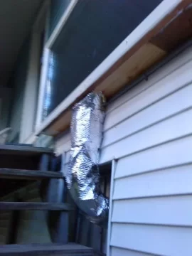

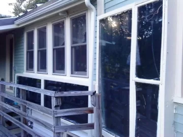

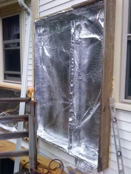

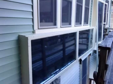

I am just about to finish My new solar heat system. Most of the isperation came from "build it solar.com" I use thermopane windows for glassing and black polyester felt for absorbers. They were simple and cheap to build with scavanged materials.

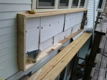

It's not pegboard it is styrofoam

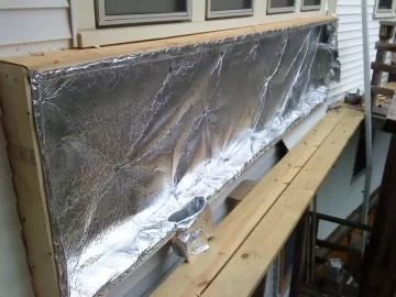

The styrfoam in the picture is the backing of the vynel sidding that I cut away. I then 2x6 framed it out with 2x6 lumber with cutouts for ductwork.
I put aluminum chanel along the edges and glued the polyester fabric on.
The air is drawn out of the celler to the lower left horizontal panel. it starts outside the fabric and is forced to go through it to get out. From the first panel it feeds into the horizontal panel on the right. Again it starts on the outside and is foced though fabric. The air goes up and back down the right side ( two windows on right) back into the celler where it is ducted to living space at the oposite end of the house.
I have not completed ducting as of yet but it apears to be raising the temp 20* on a partly cloudy day. This is not scientific, just playing around while still working on it.
There is also an anti reversion flap. This is ducted into heating ducts so that was a concern.
