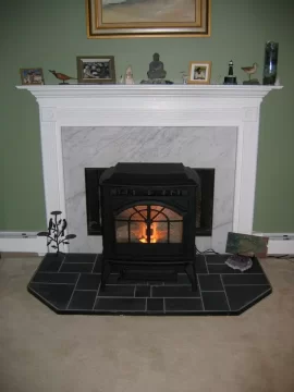

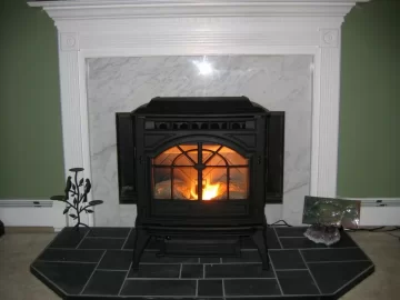

the new stove is in. we love it. i attched a couple of photos i think
unfortunately we can't seem to get it to run through the night
nuisance shutdowns i think they are called
anyone else have this problem??
thanks

Gorgeous set up, by the way.

Very pretty install...
