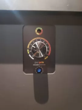

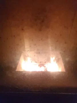

Just recently purchased the PP130b stove and installed using the Duravent 3"pipe kit. Im kinda confused on the trim/feed rate.
I was told on phone that trim adjusts both feed and air. Going to the negative gives more air and less feed. I have tried going from 0 all thru -4 and see no visual difference in flame flame seems solid ' and feed rate seems to be same. Drops a round of pellets ever 9 secs.ish. Running the comfort control anywhere from the Low to 4 setting it seems no different in operation. Under standing with the comfort 1-10 it will shutdown when getting to temp, so far this thing has yet to shutdown. I have placed digital thermometer s next to stove on side and behind and around main room. Temps inside have been 78-86. Outside temps in 40s. It is burning 3bags roughly a day(24hour period). Currently running on Low(amber solid-continuous) and trim at 4. But even when switching to the comfort zone. It is constantly feeding amd never shutting down. What temps do this shutdown at and is 3 bags a day the typical?
Current setting (green light flashes 2x) and current flame . Auger feeds every 9 sec. And room is in 80s. Only thing that changes with comfort at higher setting such as 5 is larger flame,warmer room but never shuts off . Contact 9 sec feed rate

After talking to Pelpro tech, they really only had to suggestions. Checking to make sure my Dial is calibrated properly (basically does the stove go off when dial is pointed to off. Secondly, pointing at ambient probe and its positioning (think they assumed i left still inside unit from initial opening.
So since u have had longer time owning/operating. The comfort mode is supposed to be set at a setting (example:3, and in reality this is prob just a temperature setpoint for max reading ). Once this temp is reached, the unit goes in shutdown, and then restarts after a said temp drop? Correct?
Assuming this is correct, based on what mine is doing, is it is never reaching setpoint, causing it to run nonstop and always feeding creating more pellet usage. Now i can this this unit def produces a good heat.What i have done, is take multiple digital thermometer and put 3 in front of unil( roughly 10ft away 6Ft up and 3 different directions) These three can get up to 83-86 at dial setpoint, but what i noticed is i have another meter behind unit next to ambient (ambient is pull full out of unit and mounted to wall) The meter behind is reading 7-9 degrees cooler. Makes sense since the heat is pointed forward. But this difference will cause me to never reach that setpoint.
Manual says probe needs to only extend only 2in out of unit, but extending it more into the room seems like a more accurate temp for room
After my response to pelpro, They are unsure, and since this unit is under warranty ( bought 11/17/21) they are sending me both a new dial board/ and ambient probe.
I do like unit, just trying to replace the dreaded baseboard heaters,
