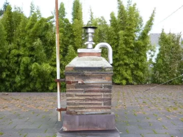

First pic is the top of the chimney, showing the flange siliconed to the top of the clay liner, the storm collar, and rain cap, and the 2" flex aluminum OAK duct exiting and pointing downward.

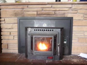

Second pic shows the Jamestown J2001 stove insert installed in the fireplace opening. Sorry, the tenants are messy. But they are happy at not having to fill the oil tank. They are running the stove 24/7, on low setting, burning a little less than a bag per day. Smoke alarm tests good, and just gave them a new CO alarm. Thermometer on the stove reads approx. 350deg F.
I am pleased with the quality of the aluminum flex tubing for the OAK. Easy to work with, and priced reasonable, at $2/ foot. The exhaust vent rain cap, however, did not want to seat all the way into the 3" SS flex liner; hopefully the replacement they are sending me will fit better.

^^best landlord ever!
Probably, :-) but between the escalating cost of heating oil, the complaints about odors (fumes?), and one of them running the lawnmower over the fill pipe, chewing up and spitting out the fill cap and leaving the tank exposed to at least quite a few rainy days, it was time to retire the oil furnace for now. Unrestrained use of electric space heaters brought on images of burnt up electrical wiring (and worse) in my head, so decided this was the best solution. Fire extinguisher is there closeby, just out of frame.
