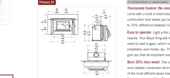

that is a wide to —not wide opening. How deep is it? Would a BK princess insert have chance of fitting. 650 sq ft with high ceilings in the dead of winter is a pretty large space and volume if you are thinking it might be lacking insulation . My experience with an f400 (1.75cu ft) in Maine would make think hard about any stove under 1.5 cu ft
