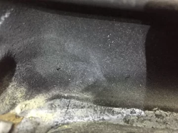

After going through the stinky curing process (really now, invest in some better paint, quadrafire's curing wasn't near as bad) I had the stove up to 600 and noticed after loading it up in the dark before I went to bed, that there was a glow coming out from one of the rear corners.
I let the stove cool down began shoveling out the ash. My grating doesn't sit flush and my shovel hits the edge preventing me from reaching all the way to the back (quite annoying) So I had to use a dustpan instead and then cleaned the remainder with my ash vac. I removed the firebrick from the back. When I did, I found a washer! Yes, it seems they forgot to put one on and were kind enough to leave it for me underneath one of the bricks. I also found two small "pockmarks" or holes if you will, behind the firebrick on the iron backing.
One, I'm afraid if I take the bolt off and reinstall the washer where it belongs I'll further crack some of their factory cement seal. making it worse.
Two, There are small holes in the iron! Theoretical weak points just waiting to crack and spread. Can it be filled with something as strong to guarantee it won't spread?
Three, The space in the back right, can it be filled with their industrial cement to repair it or maybe something isn't sitting right by not having the washer in place, causing it to go out of whack?
Four, What's the deal with the fan? 120 CFM is terrible. Is it replaceable with something stronger?
I haven't reached out to the dealer yet. I want to hear what the pros think first. ; P
