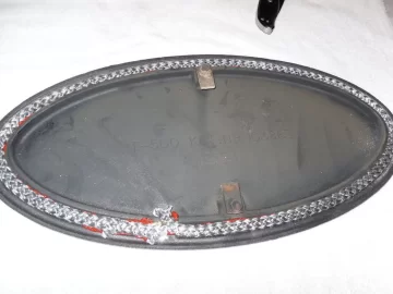

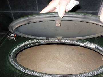

I just purchased a Jotul F600 that is still on the skid. I thought I would read through the manual and do some preliminary assembly and now have some questions for those who are familiar with this stove. First: One of the included manuals says to remove the bolts from the oval top plate to allow easier access for chimney sweeping ...makes sense, but another manual also included does not mention that at all in the installation instructions. Is it typical to remove these bolts and let the top plate rest in place by gravity?? Second Question: The front ash tray does not fit into place, the air adjustment handle seems to be in the way and the tray will not fit under it. Looks like it needs to be bent up but I really don't want to do that on a brand new stove. Any tricks to getting this tray to fit in??
