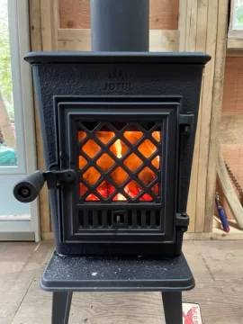

Hi everyone,
I've scanned through the Jotul 602 posts and see a lot about the way this title stove likes to roar. No exception with my new 602. I run about 15" of double wall pipe on the interior with 5 feet of insulated stainless double wall on the outside. No issues with draft whatsoever (we're at sea level) and the draw has been wonderful from day one. But wow does this stove like to burn. Currently my only accurate thermometer has been my thermo pen but it's not really set up for tis application. It's read within the acceptable levels of 550-600 degree on the boil plate.
I'm wondering if the front air control is supposed to only close half way? Mine will open fully where I see the grates open completely, and then when I close it down, it appears closed from a face on view, but looking from the right side, it's still quite open. There doesn't seem to be an option to close any further. But perhaps this is the design? Pretty impressed that it does burn so cleanly ... not any smoke at all.

The grate should close farther than that. When mine is all the way shut there's only one or two spots where I can barely see a sliver of fire light through it if I stand and look from well to the right of the stove front. Could there be an obstruction preventing it from sliding all the way left? Might take it apart and fiddle around a bit. Just pay attention while disassembling to how the two springs are supposed to be positioned in there and hang on to the little piece of flat gasket that sits on top. Might even try flipping the damper upside down.
All modern stoves allow a little air to get through even with the air control closed. This is to avoid a smoldering fire. That said, the 602's air control is pretty basic and a little sloppy. It would be good to see if a casting blob is blocking the air control from closing further or if the track it rides in is loose.
My 602cb was the same way at first then that spring loosened up and the air slide seemed to close a bit more. I could still see a slight gap in there if you look at it from the side. I think your fine.

I'm wondering if any other 602 owners out there can have a quick look at their grate in the front and tell me if, when it is shut down completely to the left, does the closure tab sit in the middle of the slot or does it slide completely to the left. Mine sits at about halfway between the middle and the left.

Great advice. I removed the grate and was able to get a little more closure in it when I repositioned the screws but the gap is still significant.

I have a new jotul 602 v2 that replaced a jotul f100, it was 10 years old and I never liked the east west loading on that small of a stove. my new 602 ran very hot you could see a lot of flame through the damper even when it was fully closed. I removed the door undid the screws and damper cover on the inside of the door you need to be careful to remember how it comes apart screws and spring, I removed the slider you may notice that on the right side of it some some casting material that prevented it from sliding fully to the right, I filed it off you may still see slight openings but the ability to damp it down will be much improved, it made a great difference

I just bought a V2 and already had a CB. If you remove the door, and take the front damper apart, you'll notice the V2 has two little casting bump outs that prevent the damper from sliding completely closed. The theory is that they did it for a hotter burn in order to pass the 2020 epa limits without a catalyst. Here's a youtube video that explains it.
